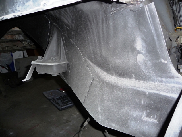

I was able to take six weeks off of work in order to help my wife recover from the C-section and, sneaked in some time on the Teener when I could too!
I cut out the rotten portion of the right side wheel house and replaced it with new metal! It was tricky to match the pieces but, I used a template to get it as close as possible! I also added two pieces of 16 gauge steel to help support the patched areas. Not sure if was needed but now I know it is double walled in those areas!

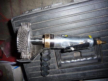

Found a wonder tool in order to help remove the old undercoating of the bottom of the chassis.
It RAWKS! (IMG:style_emoticons/default/aktion035.gif)

Zaney   I am in the process of cleaning up the wheel wells...   Aug 8 2009, 02:01 AM
Zaney   First good result in welding thinner sheet metal p...   Aug 8 2009, 02:08 AM
