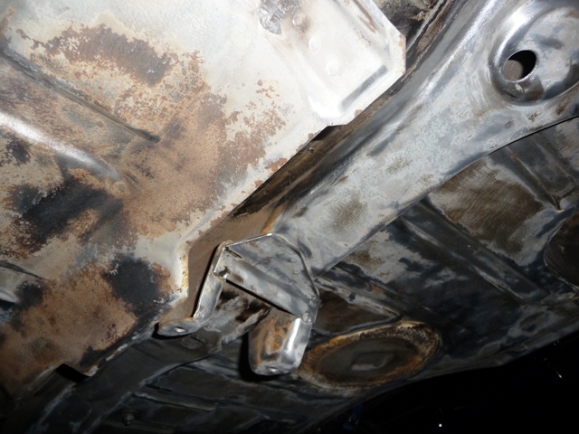

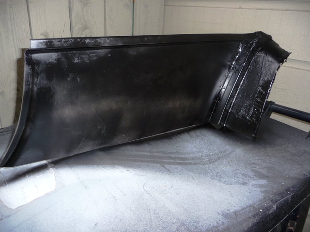

I am in the process of cleaning up the wheel wells and the bottom of the trunk area with the Flail tool. I think I am going to cut out the muffler shield in the end...
And also giving the hard to reach places the Marine clean, Metal ready and Zero Rust treatment before I weld the cut away fender panels back into place.
