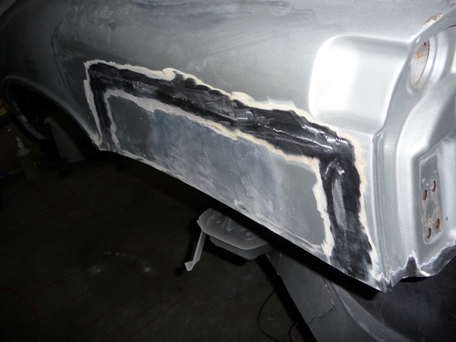

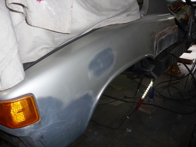

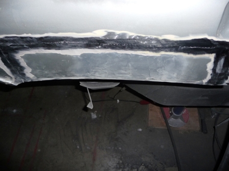

First good result in welding thinner sheet metal panels without blowing holes in it!
Next: (IMG:style_emoticons/default/welder.gif)
Fabricate or reuse the triangles for the sill
Weld in the sill and triangles
Weld the lower fender panel back in places
Fill in the turn signal markers
Repair the PO attempts with Bondo
Then, fill in the holes in rear trunk area for a previous PORSCHE reflector!
More to come!!!
