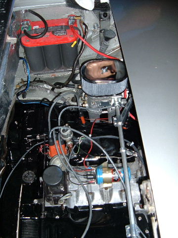

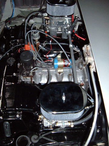

This car ran for about 5-minutes after the engine rebuild. After posting this same picture back in 2007 many of the carb set ups on this post mentioned the set up was not the best. "Money Pit" is still on jacks.
One day I'll finish my contracting work in Afghanistan to finish her up; she will rock!

QUOTE(martinef1963 @ Aug 16 2009, 07:11 AM) *
Fern
I had that same set up, you can never get the links to go right. they stick out way too far.
CB linkagewas better, but we modified it, too... moved the drop links closer to the carbs and lowered the bar lower than the lowest pre drilled hole, now it is 90 degrees at the top and bottom. very straight
