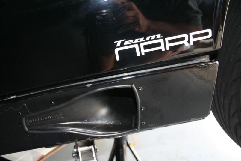

I added a scoop to my left rocker panel but it is there to duct air to an aux. oil cooler. I don't know how much air goes through it, I never tried to measure it. I installed a fairly low front valance and I noticed the oil temps running a little warmer than usual and this seemed to help.
