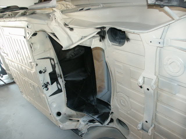

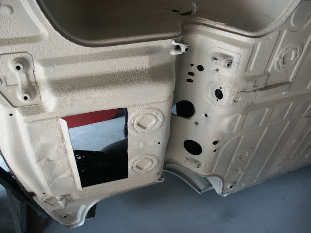

So, here are some updates. I'm extremely happy on they way everything has turned out so far.
A few pics of the Wurth undercoating:
