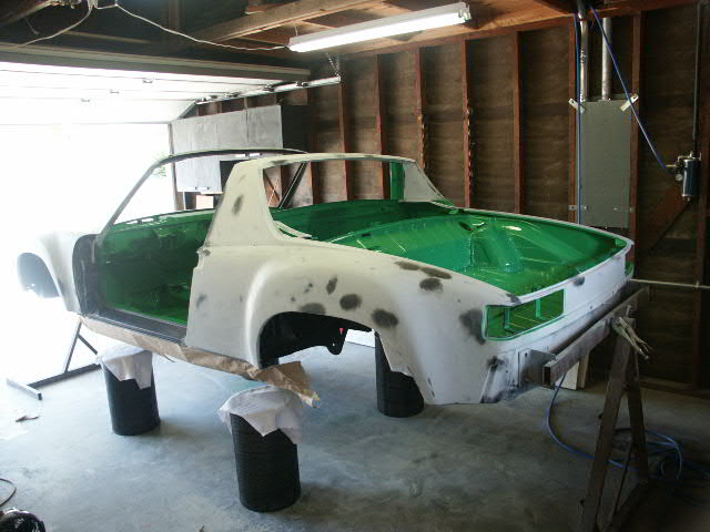

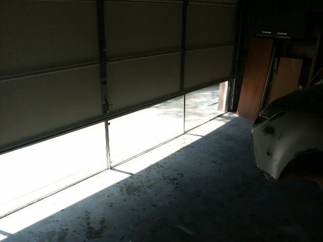

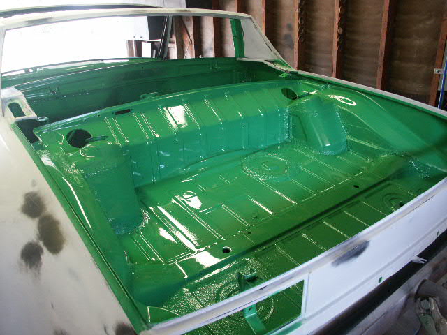

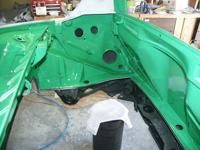

And now for the fun part. I painted the car in my garage, was able to use my 5 gal compressor with my HPLV gun. I did setup a few separators in line on the air supply to ensure no water ever made it to the gun. I used Dupont ChroMax for my base coat, it is a water based product and it seemed to work really well. The only advice I'd give anyone else doining this is to make sure you apply it on a relative warm day, it could take an hour or two for it to flash before you can apply your clear coat.
My house has a relative constant westerly wind, to take advantage of this I placed these screens under the garage door, opened rear door and installed a fan to help pull air through the garage.
A pic of the car after the trunks, passenger compartment, and engine bay were painted:
