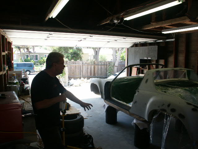

A few more:
Here's Thomas helping out with the taping- Thomas spent about 16 hours this weekend helping me out, I figured I would be able to get it done on my own, absolutely no way. Not the best pic...

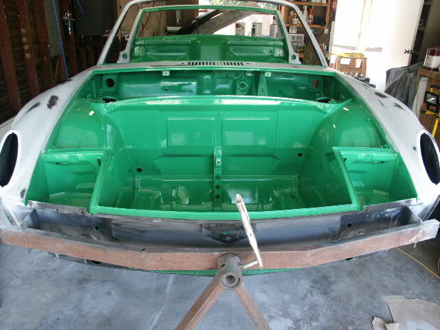

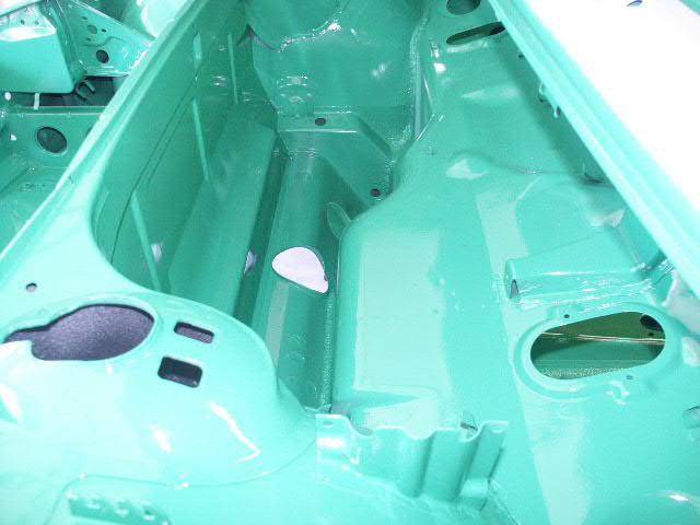

proto31   So, here are some updates. I'm extremely happy...   Aug 23 2009, 11:14 PM
proto31   And now for the fun part. I painted the car in my ...   Aug 23 2009, 11:27 PM
