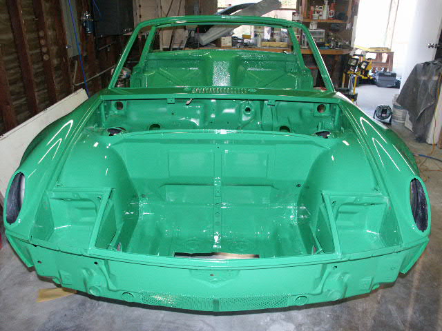

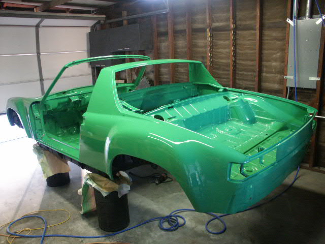

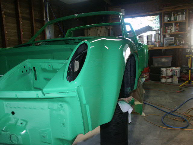

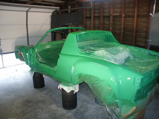

proto31   So, here are some updates. I'm extremely happy...   Aug 23 2009, 11:14 PM
proto31   And now for the fun part. I painted the car in my ...   Aug 23 2009, 11:27 PM

proto31   And finally the car (not the doors and hoods) are ...   Aug 23 2009, 11:48 PM
