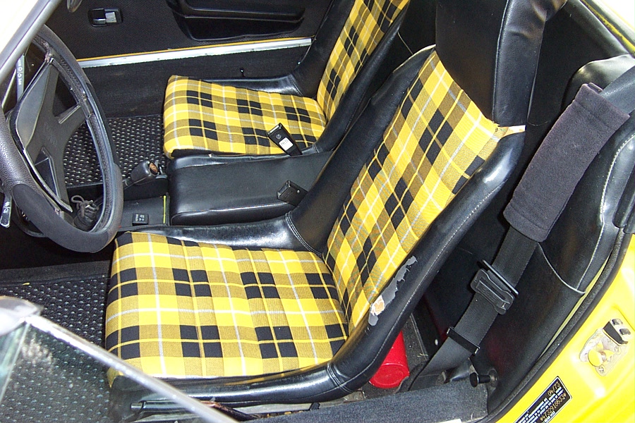

Hi Mary, Check the classifieds here for the heat exchanger. Or someone will have one and post soon. Be sure to find out which side you need and post it. Did you ever do a search for Tartan/Plaid? These were offered in the later year 914's.
Here's a couple quick links with info.
http://www.914world.com/bbs2/index.php?sho...19&hl=plaid
http://www.914world.com/bbs2/index.php?sho...24&hl=plaid
