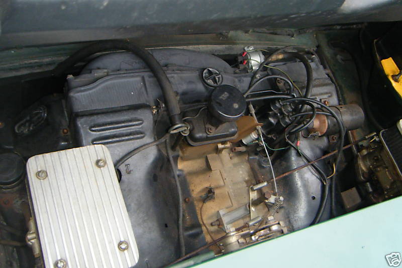

Somebody on here said this was a good linkage. It has zero slop or play in at.Attached Image

FYI, the attached may help you if you need to adjust the mechanical linkage on the carbs, I do not recall if you have the hex cross bar linkage or not.
Attached File  Syncronizing_IDF_Webers.pdf ( 331.49k ) Number of downloads: 67
