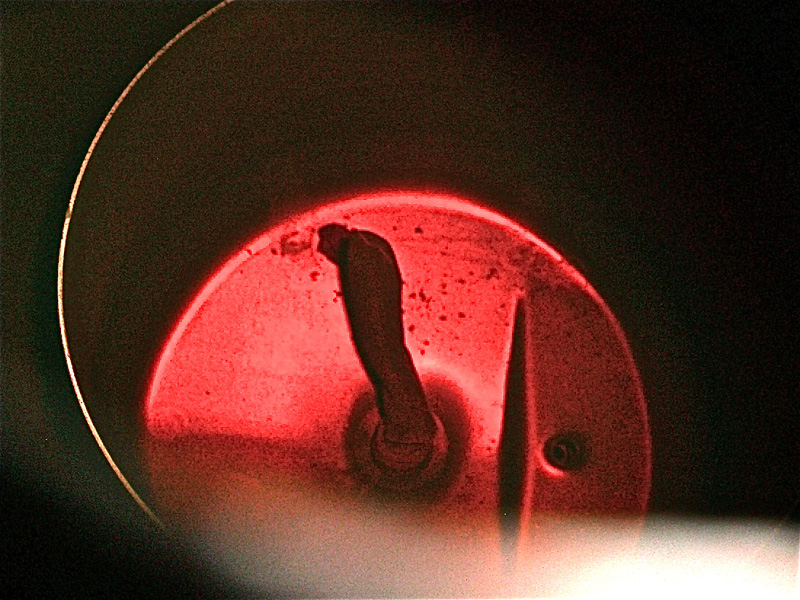

Here's a shot I just took of my sock and surrounding area. The sock looks crimped and dark to me. See the specs on the floor? The rest of the tank looks unrusted for sure, but the guy kept it filled and Stabil'd, so I'n guessing it should. Whattaya think?
Click to view attachmentQUOTE(jmill @ Aug 20 2009, 07:21 PM)

jmill
Aug 20 2009, 06:49 PM
Transition issues. What size idle jet? Check your float level and bump up your mains.
You are getting a lean transition when you go from idle jet to main jet. You need to make sure your float level isn't low. After that try bumping up your main jet to 125 or 130.
Having a low float level delays when you come on the main jets. Then you pop at @ 3K. If your float level is good bump up your main jets. I personally think they are too small. I'd go with 130's and then go smaller from there. It'll run ok if they're a bit too big. It pops and stutters or you burn up stuff if they're a bit too small.

Changing the sock and fuel line is a good idea. I'd even change out your fuel pump. Unfortunately, thats not your problem. You can't adjust float level without cracking the carb open. You can assume it's fine and go with larger mains and see what happens. You'll be out the cost of the jets if that wasn't your problem. You will have gotten away with not cracking open the carb if it was. I do have to say a lot of guys with lean transition issues seem to be running a 115 main and a F11 ET. Thats what comes in the 40 when they come from Weber. I always wondered why when IMHO the 125 was the more suitable jet. I guess it's so they can sell you more jets.
silverteener
Aug 20 2009, 07:36 PM
my tank was way worse than that. You never know that sock could be plugged. I guess if all else fails replace it. It takes a bit of labor but is a cheap fix. The socks are only around 8 dollars. good luck!
