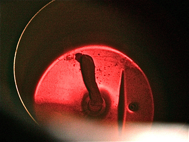

Here's a shot I just took of my sock and surrounding area. The sock looks crimped and dark to me. See the specs on the floor? The rest of the tank looks unrusted for sure, but the guy kept it filled and Stabil'd, so I'n guessing it should. Whattaya think?

kenshapiro2002
post Aug 20 2009, 06:16 PM
Posts: 1,469
Joined: 23-July 09
From: Bawlmer, MD
Member No.: 10,598
Alright...went out to do the "test". I idled her for 3-4 minutes. As I apply throttle, she starts to break up, pop and backfire (seems to be carbs and exhaust) at around 3,000 RPM, and seem to want to freeze at 3,000 or so, and even start to lose RPM. If I just keep punching her further, she seems to get beyond that behavior and rev right on up close to redline where I can hold her for a good bit of time. This is the same as when I drive her...she starts to "eff up" around 3,000-3,500 RPM, and if I just force her , she goes beyond that up to redline.

post Aug 20 2009, 07:33 PM
Green Hornet
Posts: 2,449
Joined: 9-May 08
From: Racine, Wisconsin
Member No.: 9,038
Changing the sock and fuel line is a good idea. I'd even change out your fuel pump. Unfortunately, thats not your problem. You can't adjust float level without cracking the carb open. You can assume it's fine and go with larger mains and see what happens. You'll be out the cost of the jets if that wasn't your problem. You will have gotten away with not cracking open the carb if it was. I do have to say a lot of guys with lean transition issues seem to be running a 115 main and a F11 ET. Thats what comes in the 40 when they come from Weber. I always wondered why when IMHO the 125 was the more suitable jet. I guess it's so they can sell you more jets.
