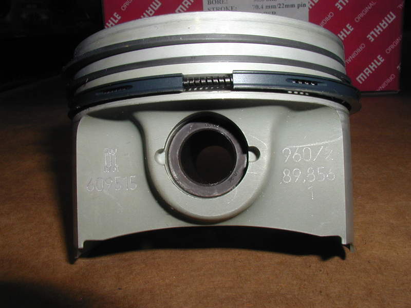

True, single plug.....it was a NOS 74 Euro Carrera dizzy a few years back, BTW.....not cheep these days. A guy could swap out the pistons ......new JEs 9.5:1 for close to a wash with the sale of the Mahles. A good twin plug set-up is pricy.

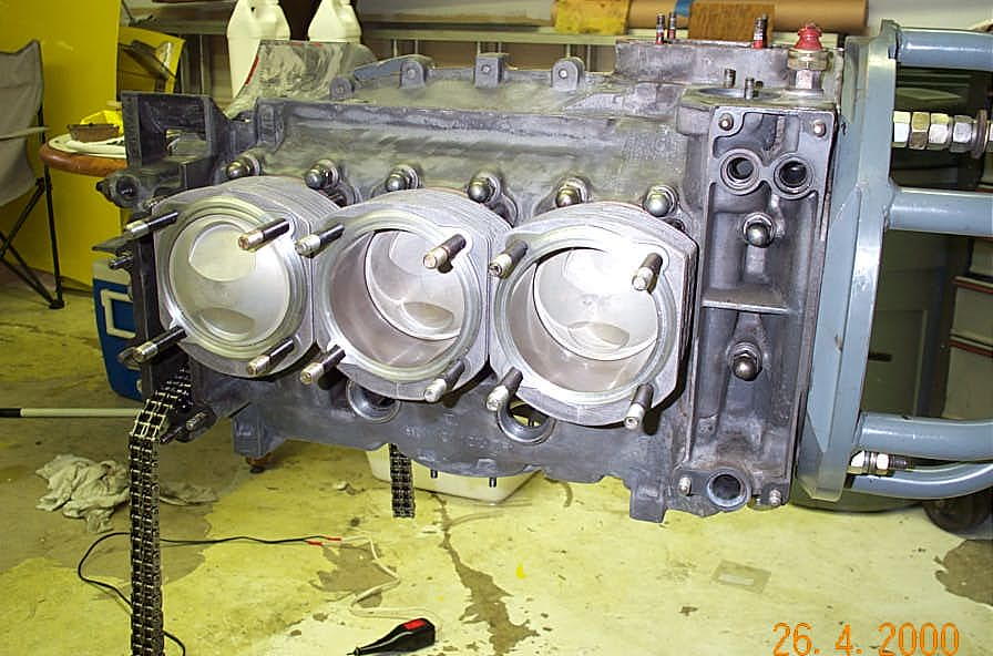

RSR clone? Sure, why not.
The carbs are 40s.
This engine would make a sweet street engine....unlike an RSR motor.
The box the P/Cs came in....plus a couple more.
