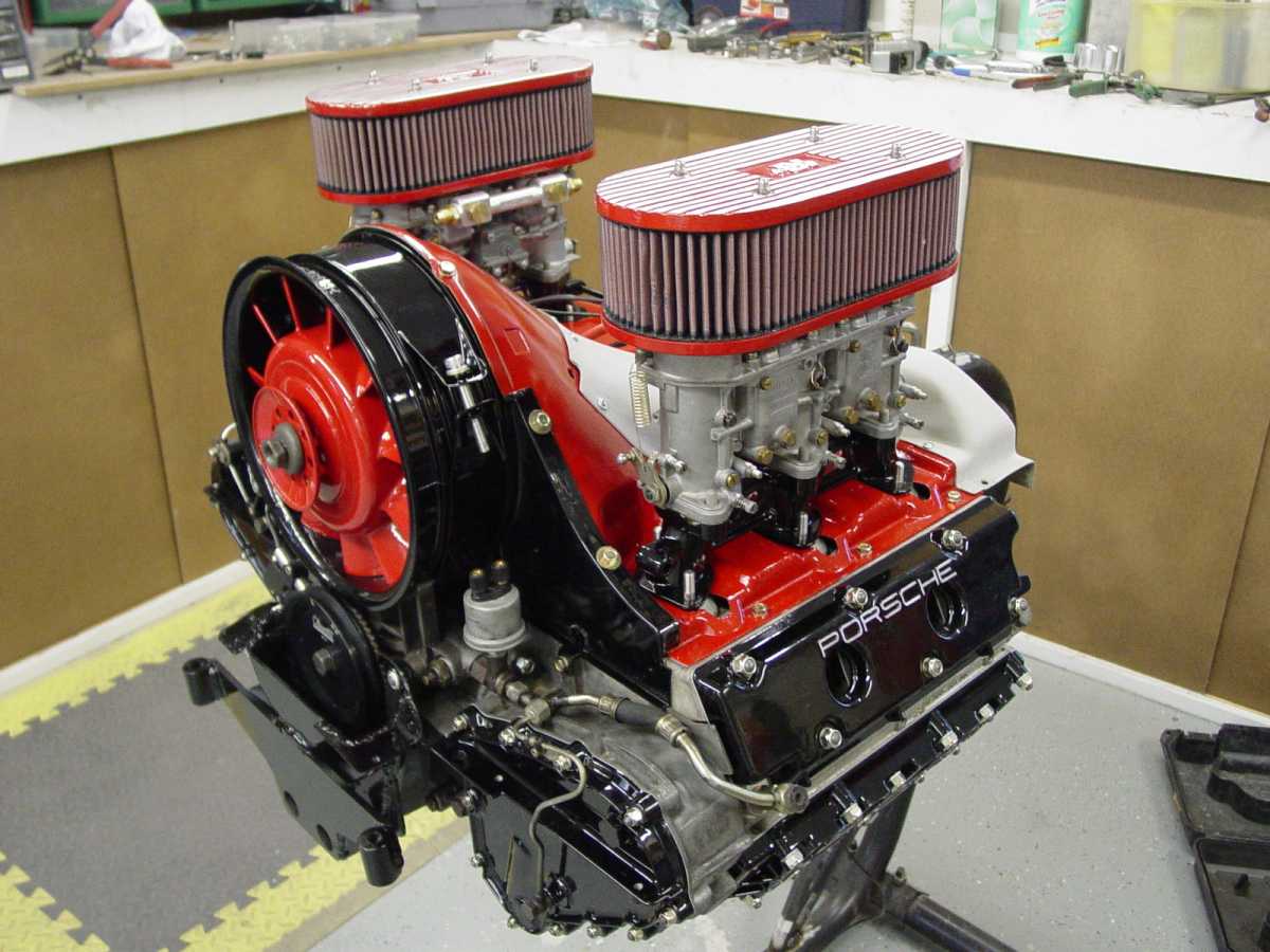

True, single plug.....it was a NOS 74 Euro Carrera dizzy a few years back, BTW.....not cheep these days. A guy could swap out the pistons ......new JEs 9.5:1 for close to a wash with the sale of the Mahles. A good twin plug set-up is pricy.
The good news is a prospective customer (or his represenative) could take a trip up the street with me to a chassis dyno and get a new set of numbers.
There is an iron in the fire (or 2) to avoid parting out the car.....we'll see.

RSR clone? Sure, why not.
The carbs are 40s.
This engine would make a sweet street engine....unlike an RSR motor.
The box the P/Cs came in....plus a couple more.
