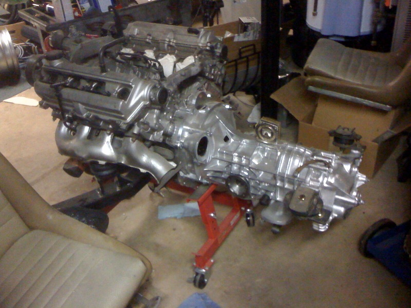

As long as I'm planning on puliing the motor YET AGAIN. I started thinking of easier ways to get the car high enough for an engine pull in a cramped garage. Has anyone figured out how to use a large engine hoist to raise the rear (or front) of a 914? -Josh2 I am currently using a hoist to lift the rear of the car. The motor and tranny sit on a HF motorcycle dolly. It works good. I made a special bumper out of angle iron and used the stock mount holes. Paul ![]() ![]() |

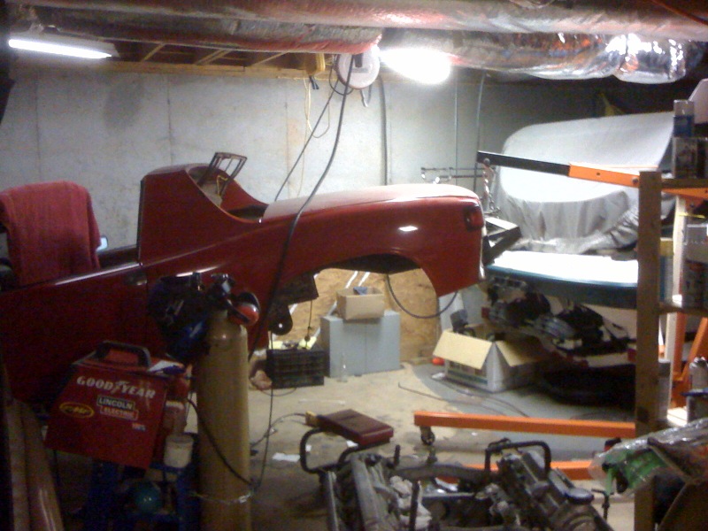

Bartlett 914 Here is a picture of my tub being lifted to be pla... Aug 30 2009, 10:25 AM

Bartlett 914 Here is another option for the engine removal. I m... Aug 30 2009, 10:36 AM
