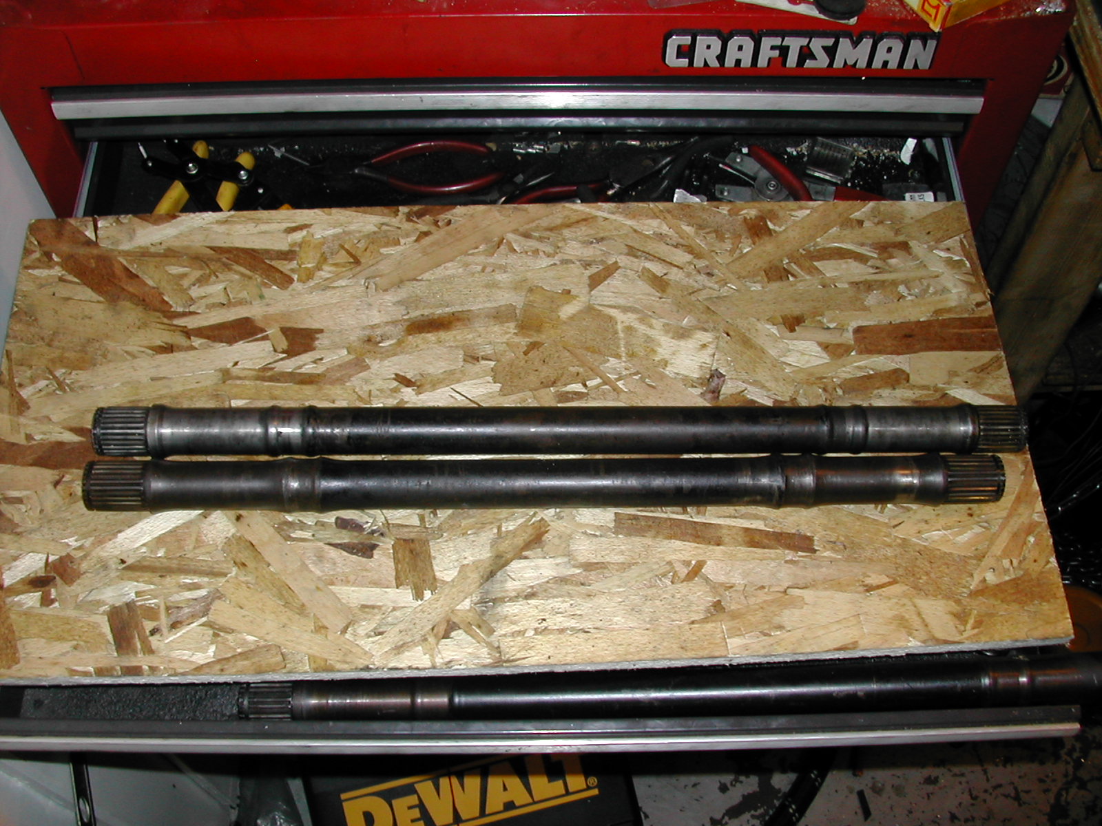

Just dealt with this. Car is a '70 914-6 (#2455). I used 911 axles which mount 100mm cv's. They are 25 spline, just like 914-6 axles, but 0.75 inch shorter as seen here:

brp986s   Just dealt with this. Car is a '70 914-6 (#24...   Aug 30 2009, 10:07 PM
brp986s   Although the 911 and 914-6 axles are 25 spline, a ...   Aug 30 2009, 10:14 PM
brp986s   You can use a 100mm 911 stub in a 914-6 hub. Both...   Aug 30 2009, 10:19 PM
brp986s   To make it work, get 0.75 inch spacer. This one m...   Aug 30 2009, 10:24 PM
