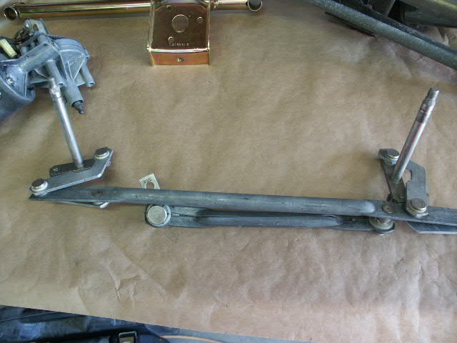

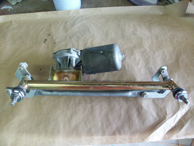

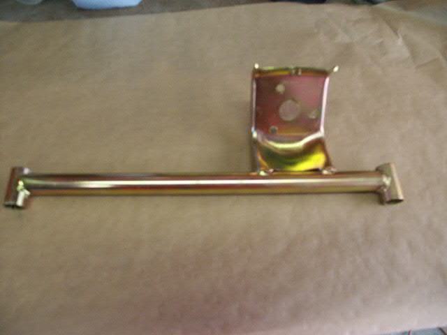

Rebuilding the windshield wiper assembly, zinc plated the mounting bracket, cleaned everything else up and re-greased everything:
Finished:
