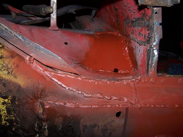

One last hole in the longitudinal patched.
Engine tin piece is in too. Previous engine tin replacement didn't match up well with the hell hole and firewall.
