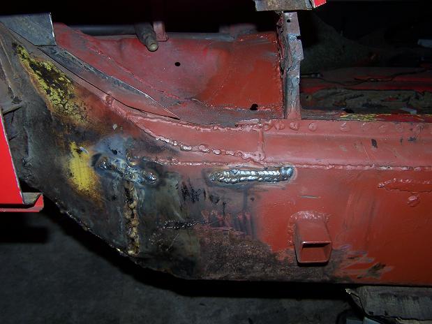

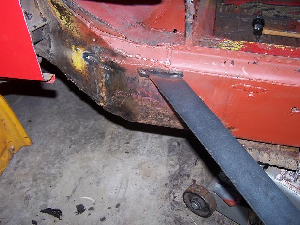

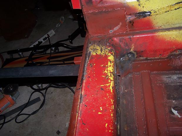

I have a metal bar sitting around so I thought I would try to strengthen the long by weliding the bar into the top of the long.
Added 2 more bars under the hell hole.
Bars are cut and welded in. Don't know if this will help the rigidity of the long but it's easy to do.
