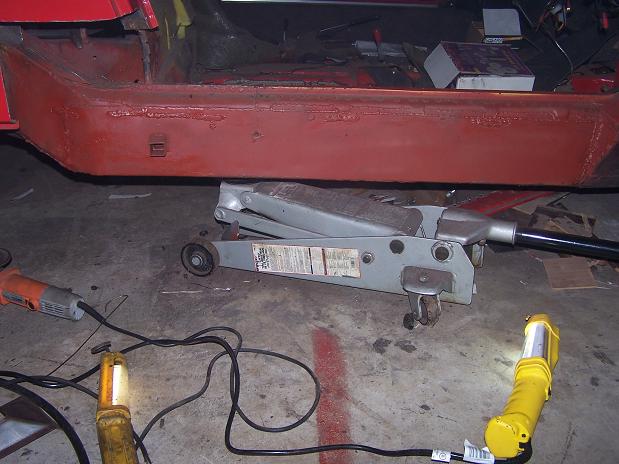

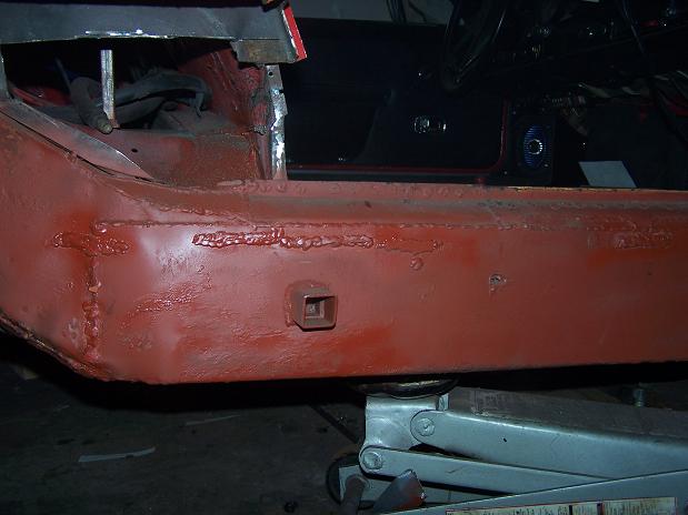

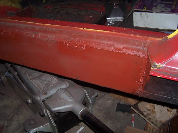

Put a couple more steel bar supports in the long.
Cleaned up all the brushed-on tar on the outside of the long and primed it. Looks like a blank canvas to me.
