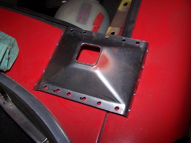

Jack support plate ready for welding.

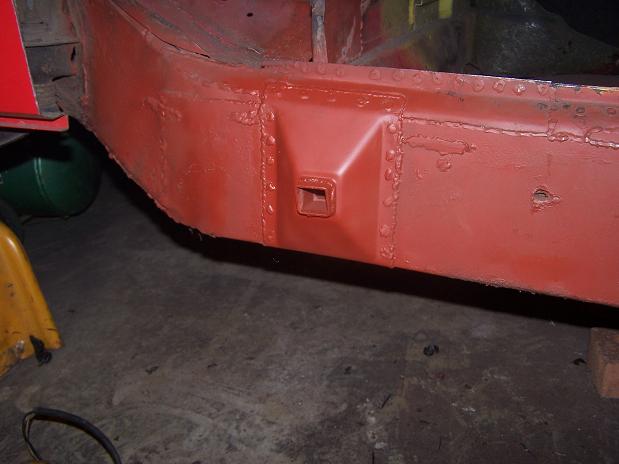

Presto!

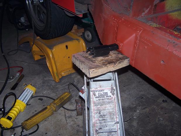

For the first time in probably 15 years, the car can be jacked up by the jack tube.

Spoke   Jack support plate ready for welding. Presto...   Sep 14 2009, 05:57 AM
