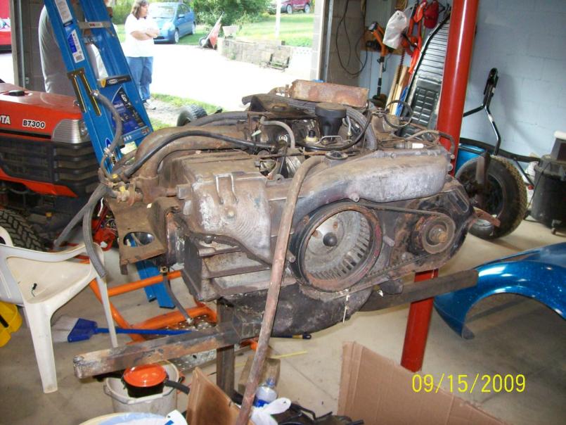

Everyone,
I would like to know how much of a problem it would be to take 1.7 914 FI engine and convert it to a carbs to put into a Bradley GT project car. The body kit is an original 1976 model that was never put together. The Bradley was purchased by my cousin and I have the spare engine. The engine (in a barn for the last 15 years) will be torn down for inspection and parts replaced as needed.
Thought this would be a good way to reuse the 1.7 since most of the other comments I have heard or read for this type of engine were less than favorable.
Should the engine get a big bore kit, cam, dist, low pressure fuel pump? If so, does anyone have the required parts for the conversion? How much?
Thanks for your input!
Jays914

More pictures 9/15/09

jays914   More pictures 9/15/09   Sep 15 2009, 07:46 PM
jays914   Yet another picture 9/15/09   Sep 15 2009, 07:49 PM
jays914   One last picture for today 9/15/09   Sep 15 2009, 07:52 PM
