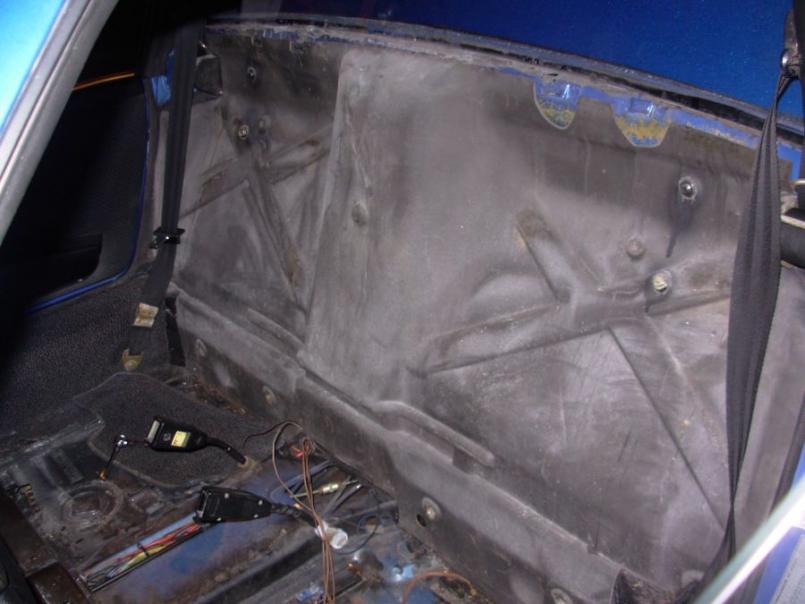

Dominic   Zach, Here is a picture of the firewall (engine si...   Aug 12 2008, 08:21 PM
