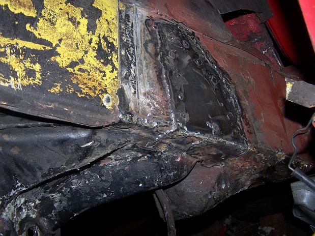

Cleaned back to good metal and patched. That looks better.

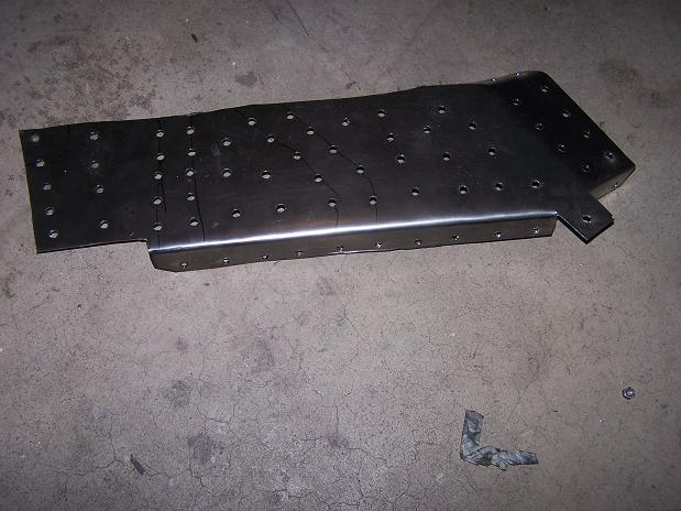

Home made clamshell ready to be welded in place. This will go from above the suspension pickup all the way to the jack support.
