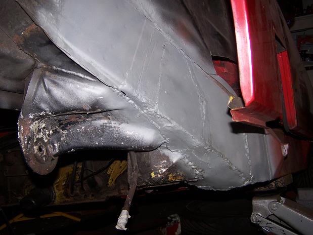

Here's pics after last year's rear end accident that totaled the car and the finished product after many months of rehab.

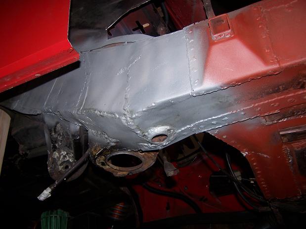

The long is ready for the support plate. The gray weld-through primer.
