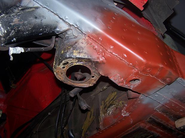

The support plate is welded in. Gray weld-through primer is on where the suspension pickup will be welded on.

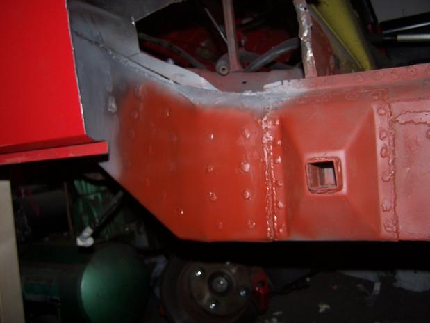

Spoke   Jack support plate ready for welding. Presto...   Sep 14 2009, 05:57 AM
Spoke   After some deliberation, I decided to investigate ...   Sep 21 2009, 08:54 PM
Spoke   Cleaned back to good metal and patched. That looks...   Sep 22 2009, 05:44 AM
Spoke   The long is ready for the support plate. The gray ...   Sep 24 2009, 10:08 PM
Spoke   The support plate is welded in. Gray weld-through ...   Sep 24 2009, 10:12 PM

Spoke   The suspension pick-up will be seam welded, then t...   Nov 16 2009, 04:05 AM
Spoke   The suspension pick-up is welded on including the ...   Nov 16 2009, 04:17 AM
Spoke   Finally time to patch up the hole looking into the...   Nov 16 2009, 04:23 AM
Spoke   Support plates between inner and outer suspension ...   Nov 16 2009, 05:03 AM

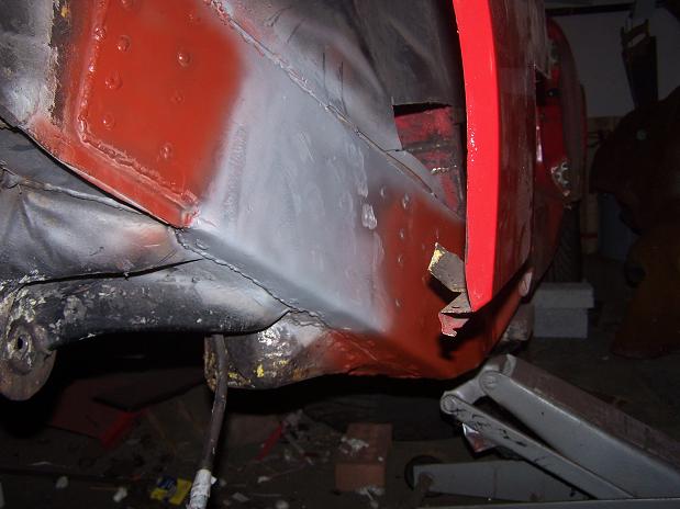

Spoke   The original hell hole repair put that little patc...   Nov 21 2009, 08:43 AM
Spoke   And Presto! The 2 plates may add a little bit ...   Nov 21 2009, 08:48 AM

Spoke   The passenger side engine shelf is a replacement. ...   Nov 21 2009, 10:32 PM
