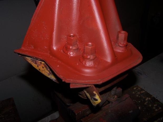

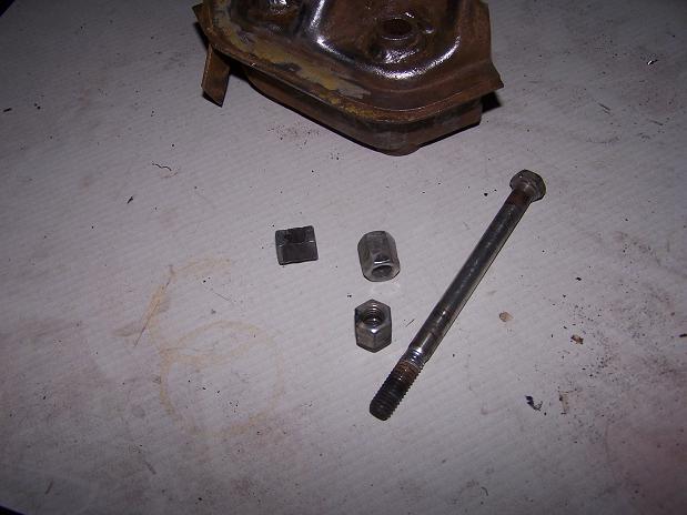

What to do if your nuts are too small: weld 2 together (IMG:style_emoticons/default/biggrin.gif)
The PO drilled out the existing bolts probably when they rusted and snapped.
So weld 2 nuts together and weld on top of the existing drilled-through sleeve.
Nuts are welded on now. I just need to find something to cover the top of the nuts like the original plastic cap did.
