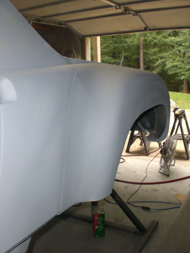

been working on my project for awhile now,, read a long time!!!!..latest update..she's not naked any longer...2 years of bare metal and now I started spraying...... First time.. I'm handling the primer on my own.. (IMG:style_emoticons/default/wacko.gif)
Bigkat is traveling for work or some lame excuse!! (IMG:style_emoticons/default/beer.gif)
He will be handling the final hot rod black..
acid etch primer and the gray primer
