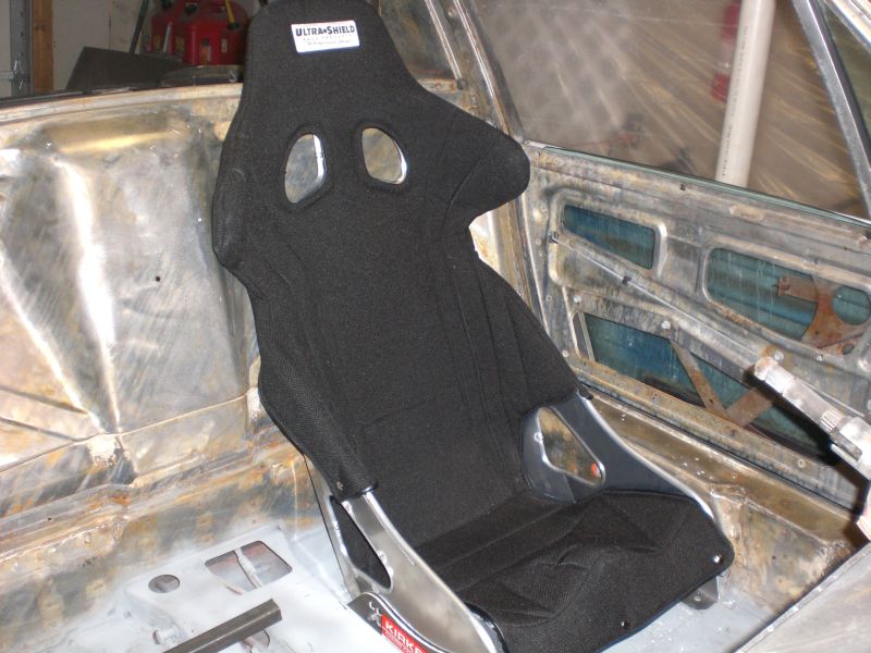

From: Atlanta, ga
Member No.: 904
seats,,,ultra shield rally

d914   seats,,,ultra shield rally   Oct 4 2009, 02:56 PM
