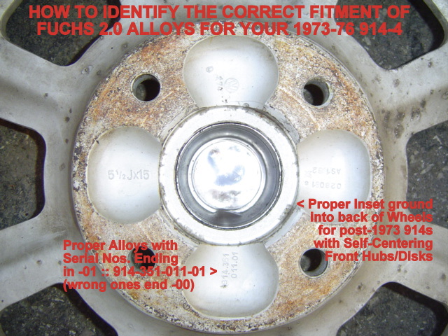

Yes Murry, they absolutely will NOT fit properly against the face of the hub/disk-rotor IF your front hubs are hub-centric (also called "self-centering" hubs)! Do NOT run a -00 wheel of any flavor on hub-centric front hubs/disk-rotors.
This is because the small lip of the ring around the center hub/dust-cap which sticks out a few mm's from the hub/disk-rotor's surface will hold the face away from fully seating on the hub/disk-rotor, which can then "wobble" that amount & damage the lug bolts, rotor, etc. - costing a bunch of $'s to fix, even if there is never an accident as a result.
The inset on the back of the wheel shown in this pic below, shos where the lip fits into, in order for the rest of the wheel back-face to seat properly & flat on the hub-centric front hubs/rotors.
So first check to see if you have a hub-centric front rotor, then act accordingly - i.e.: use only the -01 type wheels if hub-centric, or either -00 or -01 if not. If the PO had ever changed the front rotors due to wear - or if you do yourself, chances are that even the non-hub-centric hubs/rotors up front are/will be hub-centric replacements, since that's the proper spec for your 73 2L (914S (IMG:style_emoticons/default/smile.gif) ).

Proper Part #...-01 Fuchs Wheel at back face:
