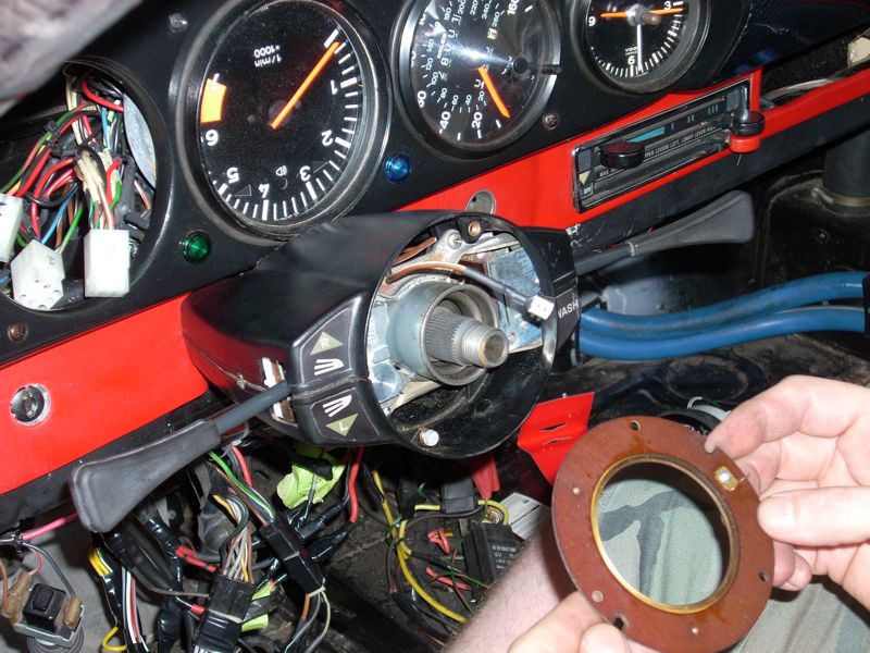

I went ahead and ordered all the parts needed to convert my currently trashed steering column to a 911 unit with the 911 keyswitch and column lock ...
i should have all the parts early next week. i'll post pictures of the install as i go along ...

And finally putting it all back together.
The key lock actually is almost dead on in the same spot as the factory hole for the foglight switch!
