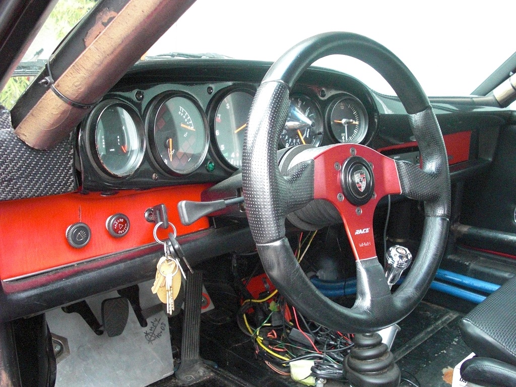

post Oct 11 2009, 01:37 PM
Resident German
Posts: 42,517
Joined: 21-January 03
From: Oakland, Kalifornia
Member No.: 179
Don't mind the wiring mess on the floor (IMG:style_emoticons/default/biggrin.gif)
And i still have to install the black plastic surround for the switch.

SirAndy   finally made some progress with this ... the colu...   Apr 20 2008, 03:22 PM
SirAndy   Alright, let's finish this thread off with som...   Oct 11 2009, 12:39 PM
SirAndy   We then removed the original mount and the end bra...   Oct 11 2009, 12:44 PM
SirAndy   The hole where the 911 switch passes through to me...   Oct 11 2009, 12:50 PM
SirAndy   Testfitting the assembly: Note that i used a piec...   Oct 11 2009, 12:53 PM
SirAndy   And finally putting it all back together. The key ...   Oct 11 2009, 12:56 PM
SirAndy   Once i'm done waking up, i'll take a pictu...   Oct 11 2009, 12:57 PM
SirAndy   Don't mind the wiring mess on the floor :D A...   Oct 11 2009, 01:37 PM
