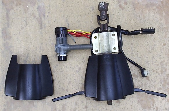

type47fan
post Mar 21 2008, 10:13 PM
It Looks Better In Person. . .
Posts: 860
Joined: 17-September 03
From: Carlsbad, CA
Member No.: 1,170
. . . . examples of the real thing . . . .

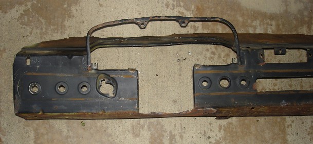

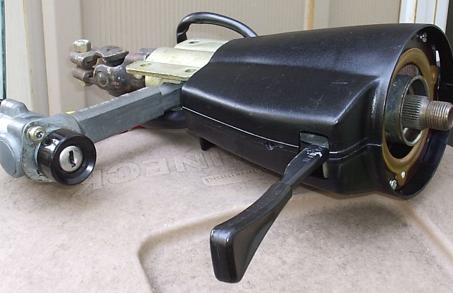

SirAndy   finally made some progress with this ... the colu...   Apr 20 2008, 03:22 PM
SirAndy   Alright, let's finish this thread off with som...   Oct 11 2009, 12:39 PM
SirAndy   We then removed the original mount and the end bra...   Oct 11 2009, 12:44 PM
SirAndy   The hole where the 911 switch passes through to me...   Oct 11 2009, 12:50 PM
SirAndy   Testfitting the assembly: Note that i used a piec...   Oct 11 2009, 12:53 PM
SirAndy   And finally putting it all back together. The key ...   Oct 11 2009, 12:56 PM
SirAndy   Once i'm done waking up, i'll take a pictu...   Oct 11 2009, 12:57 PM
SirAndy   Don't mind the wiring mess on the floor :D A...   Oct 11 2009, 01:37 PM
