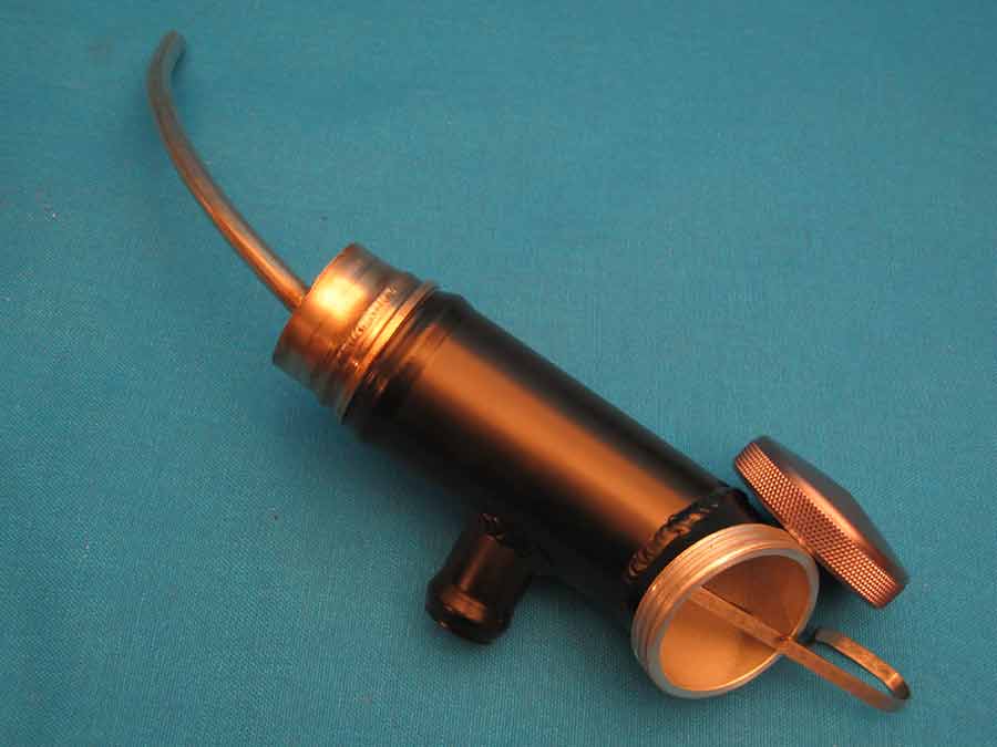

scotty   Velios used to make a cast aluminum tank, it...   Oct 15 2009, 11:22 PM
SirAndy   I love the fill pipe...is that copper anodized? ...   Oct 15 2009, 11:29 PM
