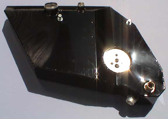

I have one of Don's tanks with filler neck and all.
Great product, great quality!
Andy
PS: They're still listed here, not sure about availability:
http://rebelracingproducts.com/EngineRelated.htmlClick to view attachmentClick to view attachmentClick to view attachmentClick to view attachment

When I finally had the funds I purchased one of Don's tanks, like Andy pictured. The only place I could find it was at Patrick. It is a very nice piece!

That pictured tank is a work of art -- I love the fill pipe...is that copper anodized?
Oct 15 2009, 11:29 PM
QUOTE(scotty @ Oct 15 2009, 09:22 PM)
No. It's "mood" lighting ...
The filler neck is aluminum, just like the rest of the tank.

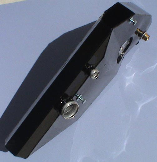

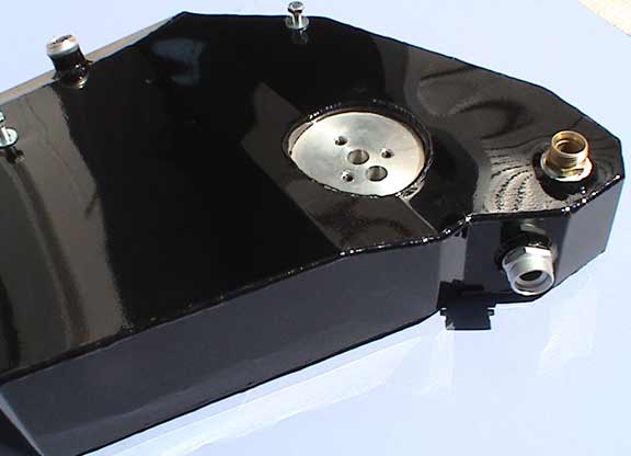

photobucket ate my pictures..
but i finally found these tucked away:
my template and
the internal baffling
brant
Oct 24 2009, 08:17 AM
these pictures were taken before welding was finished.
some of the seems are only tacked

Oct 25 2009, 09:08 AM
a couple more pictures, but they don't show anything more really:
mild steel would be fine
just use steel fittings
it helps a ton to have access to a big break
I did this tank in my votec welding class, and they had a number of helpful tools around that shop.
An old style radiator shop would be a good place to start with a rusty tank
I would think it could be easily brazed or repaired
clean it well with a wire brush to expose all of the rusty areas
