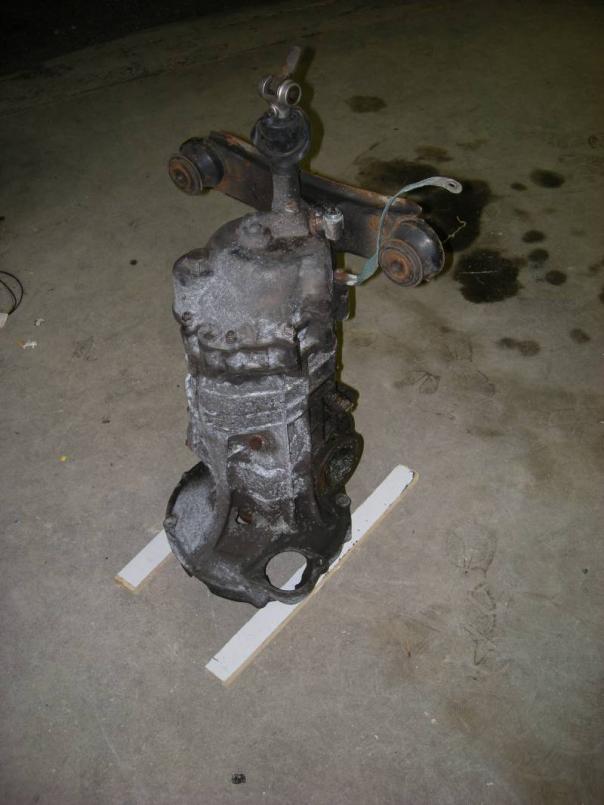

In one weekend the Doc totally demistfied the 901 transmission and manual transmissions in general.
Because the only transmission I've ever taken a peek at was the aircooled VW, I've been scared of tranny's like a little girly-man.
I'm not an expert yet, but I hope Mike would say I'm compitaint.
I have 2 transmissions built from the clinic, plus enough spares to build a another 901 if I had another core.
In this pic, if you look at top 1/3, center, you can see (on the pegboard hook) dog teeth, 1st sliders, sider and a few bands. Nice score.
2nd pic is the 911 901 that the Doc built as a demonstrator, same thing as a 914, just a bit different on the nose cone and selector.

The sickness continues......
(IMG:http://www.914world.com/bbs2/uploads/post-26-1256092666_thumb.jpg)
Dave can I borrow your dog teeth puller (IMG:style_emoticons/default/poke.gif)
