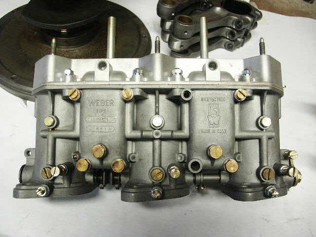

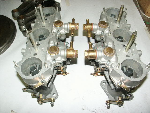

The carbs, completely rebuilt, ultrasonically cleaned-

proto31   The carbs, completely rebuilt, ultrasonically clea...   Oct 22 2009, 11:10 PM
