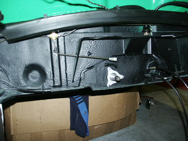

Rear brake hard lines, with T instead of proportioning valve-

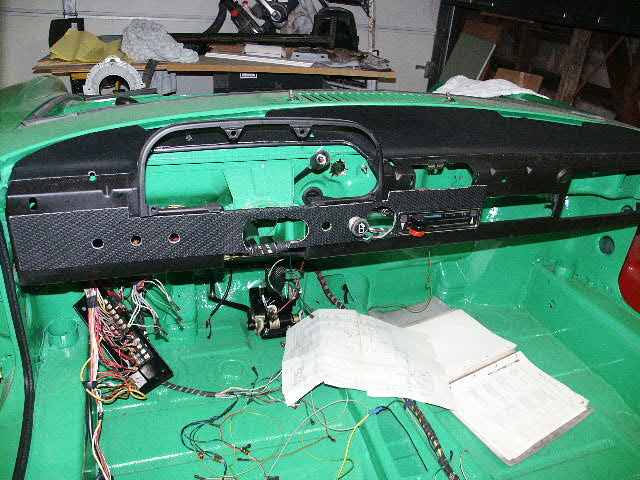

Upper dash frame-

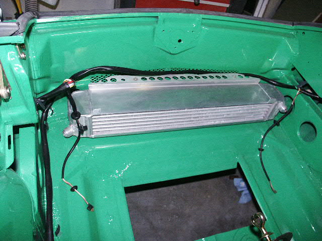

Front oil cooler test fitting-
