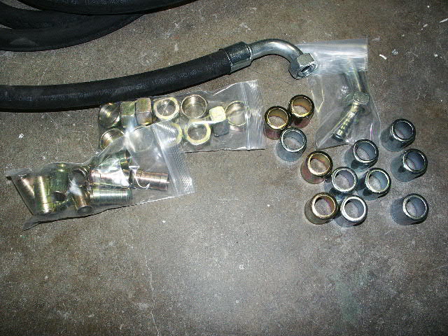

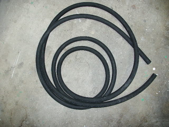

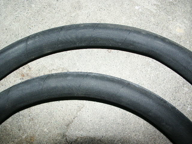

I got my oil line from Rebel Racing, they are original wrapped Cohline, you give them a rough estimate of the total footage and the type of fittings needed, they send you the complete line with fittings, you cut and fit everything how you like and send them back marked, they crimp all the fitting and send it back to you. Custom oil lines that will last forever and look factory, very reasonably priced.-
