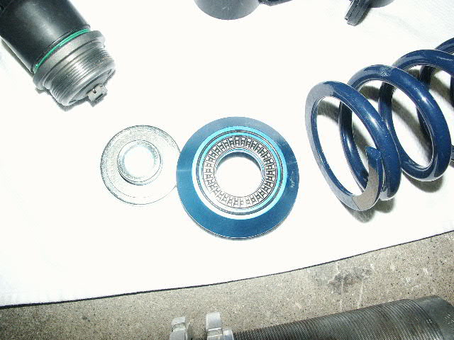

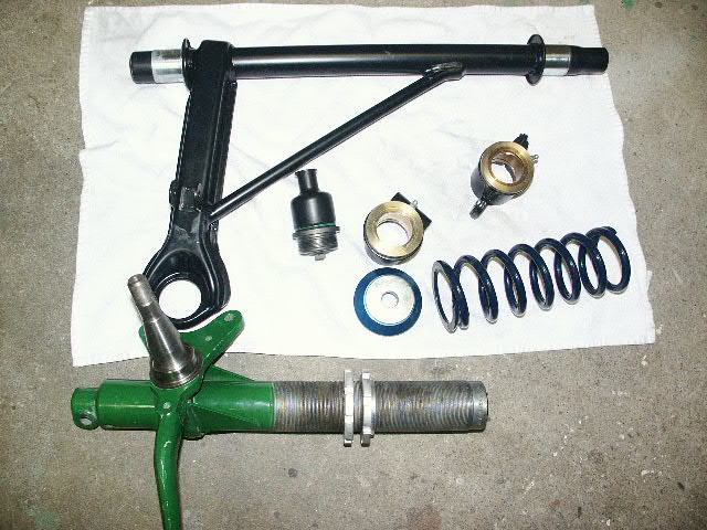

Here's some previews of the front and rear suspension, real 935 front struts, coil overs with needle bearings (Rebel Racing again)-
Close up of upper bearing-

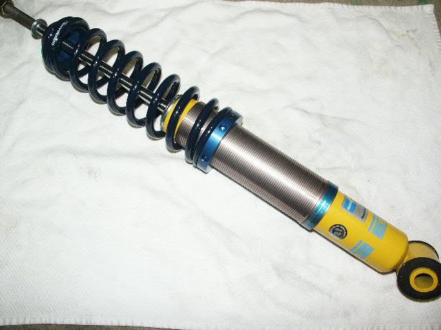

Rear coil overs-
