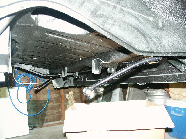

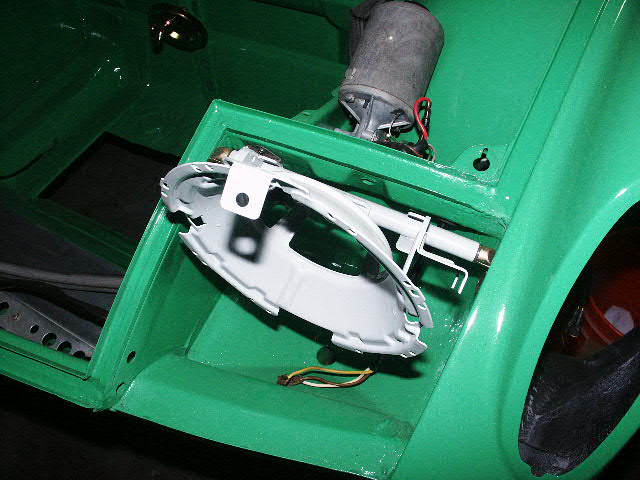

Headlight installation-
Rear sway bar (stock)-
cwpeden
post Oct 23 2009, 03:11 AM
Great White North, huh?
Posts: 916
Joined: 20-August 06
From: Victoria BC
Member No.: 6,693
It may have already been mentioned, but I think your rear sway bar is upside down. Had mine the same and it hit the cross member right where it takes the bend down.
