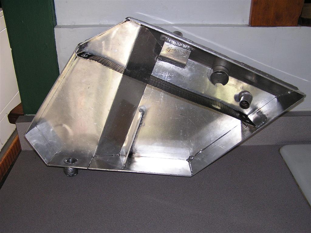

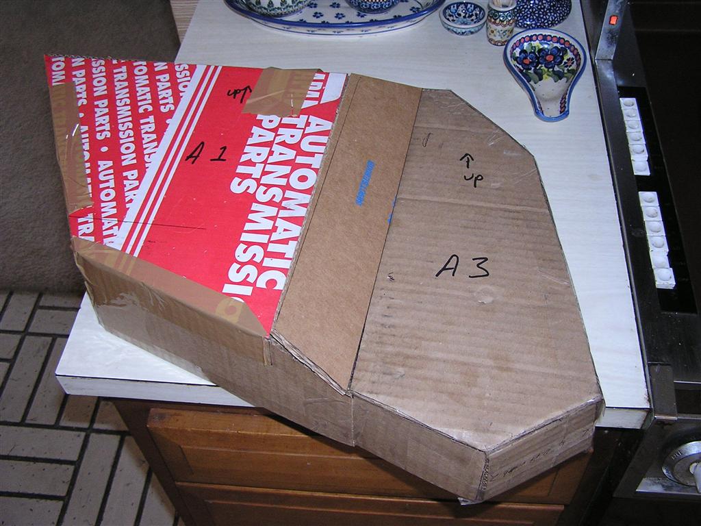

post Oct 24 2009, 08:15 AM
Posts: 12,167
From: Colorado
Member No.: 47
photobucket ate my pictures..
but i finally found these tucked away:
my template and
the internal baffling

brant   photobucket ate my pictures.. but i finally found ...   Oct 24 2009, 08:15 AM
brant   these pictures were taken before welding was finis...   Oct 24 2009, 08:17 AM
Mark Henry   Thanks brant! any more pics? If it was mild s...   Oct 24 2009, 04:35 PM
brant   a couple more pictures, but they don't show an...   Oct 25 2009, 09:08 AM
brant   and:   Oct 25 2009, 09:09 AM
