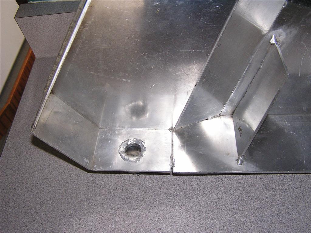

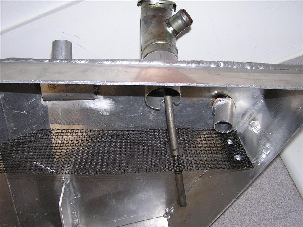

a couple more pictures, but they don't show anything more really:
mild steel would be fine just use steel fittings it helps a ton to have access to a big break I did this tank in my votec welding class, and they had a number of helpful tools around that shop. An old style radiator shop would be a good place to start with a rusty tank I would think it could be easily brazed or repaired clean it well with a wire brush to expose all of the rusty areas Attached thumbnail(s) |

brant photobucket ate my pictures..
but i finally found ... Oct 24 2009, 08:15 AM
brant these pictures were taken before welding was finis... Oct 24 2009, 08:17 AM
