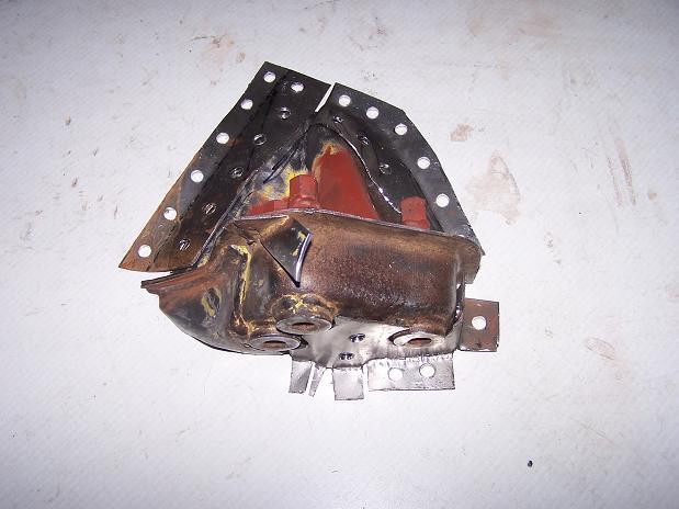

The suspension pick-up will be seam welded, then these 16 gauge plates will secure the pick-up on the long.
