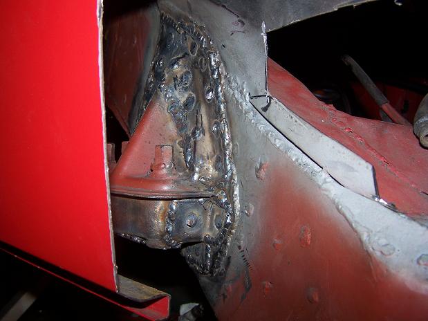

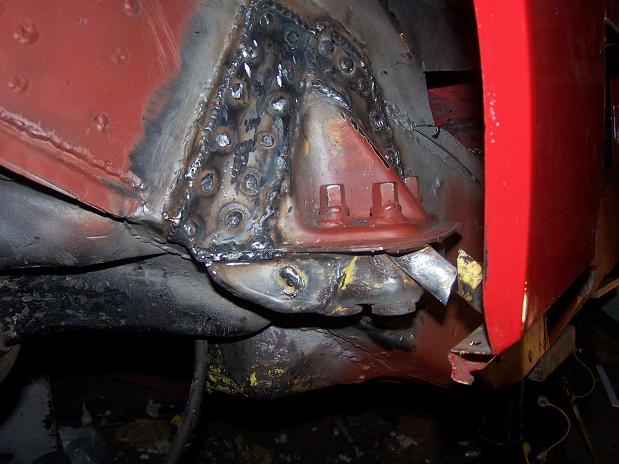

The suspension pick-up is welded on including the support plates.
The geometry of this corner is all messed up from the previous hell hole repair where the inside suspension pick-up was replaced and mounted about 3/4 of an inch too low.
This means for proper camber I needed almost 1 inch of shim plates. Since I would never be removing the inside suspensino pick-up, I decided to lower the outside suspension pick-up about 5/8 of an inch to minimize the stack of shims needed. This drop can be observed by looking at the support strap to the fender.
