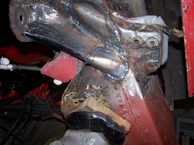

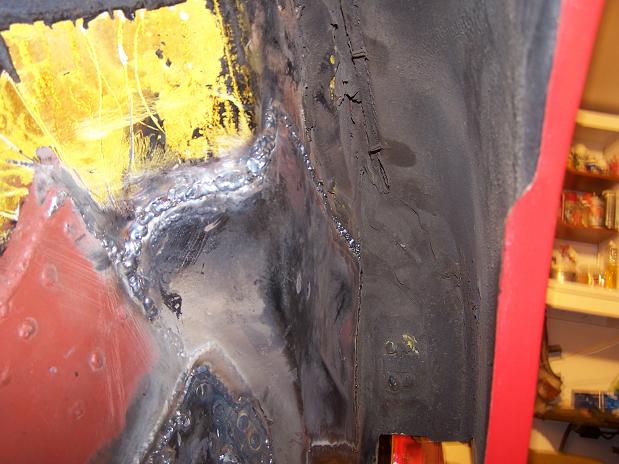

post Nov 16 2009, 05:03 AM
Jerry
Posts: 7,437
Joined: 29-October 04
From: Allentown, PA
Member No.: 3,031
Support plates between inner and outer suspension pick-ups are welded in.
A PO repair to the inner fender wall only seam welded the new wall from the inside. Now the replacement piece is welded from the outside as well.
