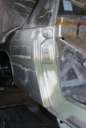

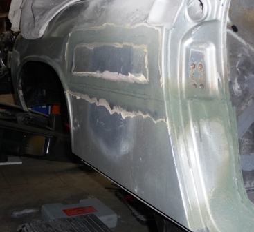

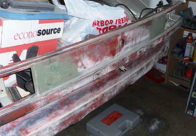

Finally some time to UPDATE!
Welded up the door jam and the rocker sill & triangles.
Lower piece of fender
Filled in the PORSCHE reflector holes in the rear
