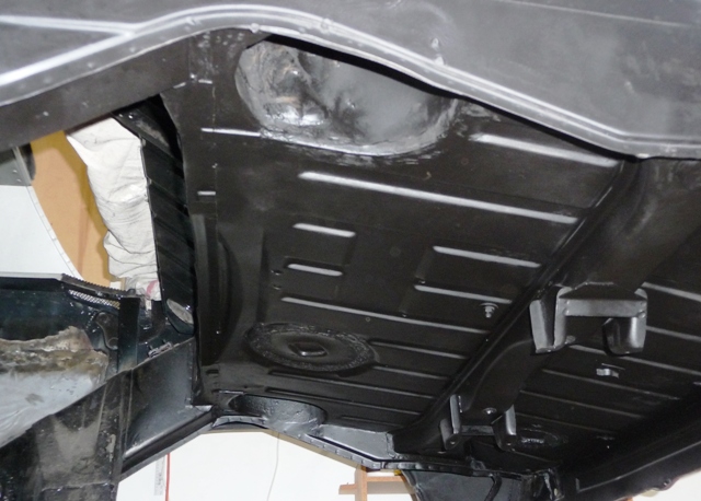

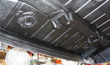

Cleaned the underbelly where the Trans and Muffler will go.

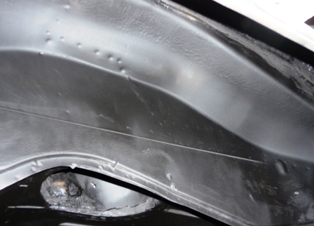

Driver's rear wheel well
Muffler shield removed and area treated for Rust! (IMG:style_emoticons/default/sawzall-smiley.gif)
