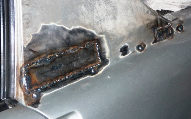

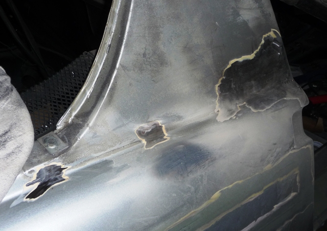

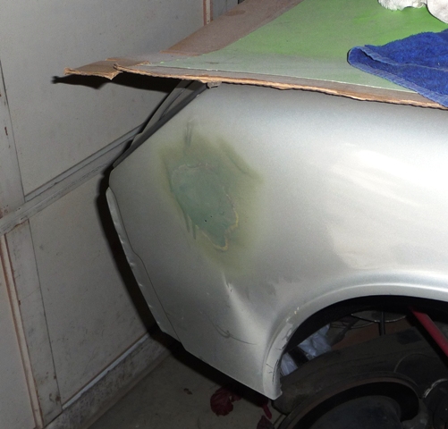

Filled in the side markers and Sold them to Fourblades
Planned on removing the Sail Vinyl but, took care of Mucho rust too! (IMG:style_emoticons/default/chair.gif)
More on passenger side and smoothed out too! (IMG:style_emoticons/default/welder.gif)
